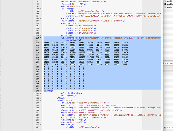

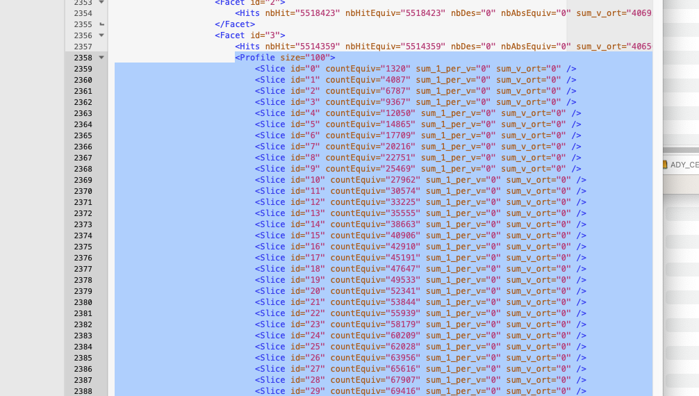

I did a test, both angle maps and the profile slices are saved with the XML file, even when running a simulation with molflowCLI:

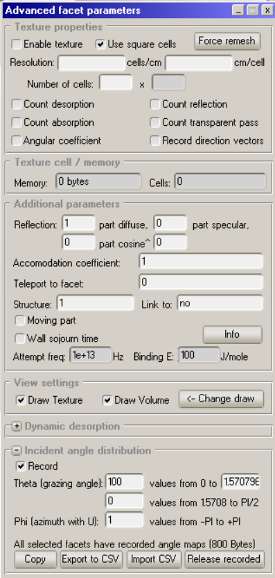

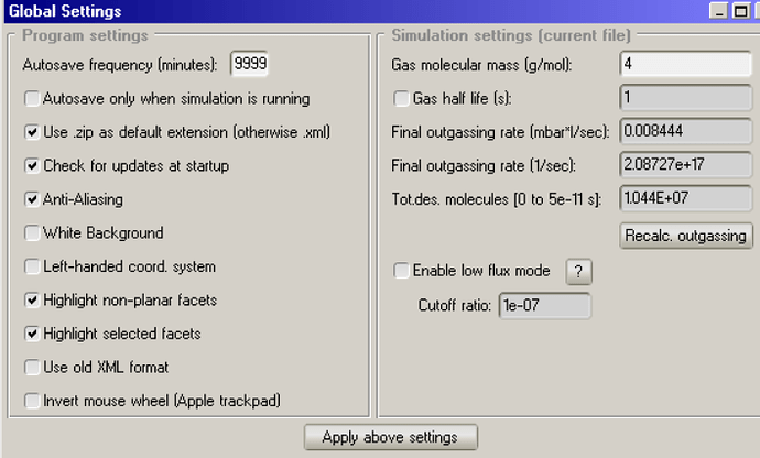

I`m trying to get the angle map. As far as I understand, you just have to activate the recording. I´ve also added the global settings, maybe I need to change something there?

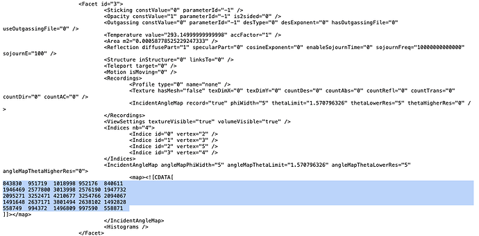

The angle map recording, in fact, worked correctly, if you open the XML file that you’ve ran on the server, the angle map is saved correctly in the file at the facet’s node, for example something like this:
