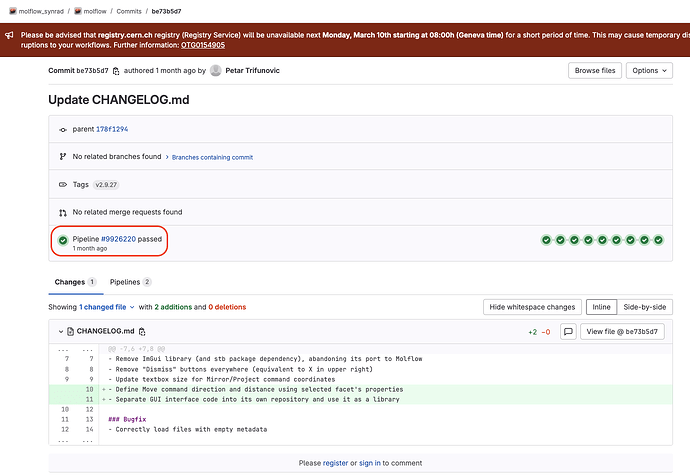

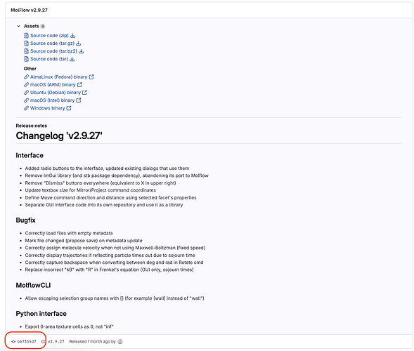

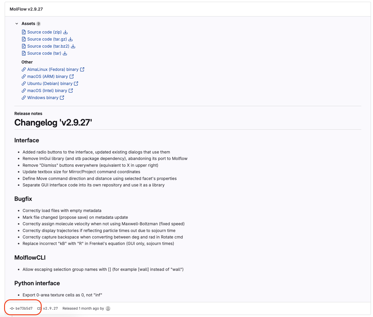

  1. You click on the commit belonging to a Molflow release, lower left:
  2. You click on the pipeline:
  3. You download the MPI version:
