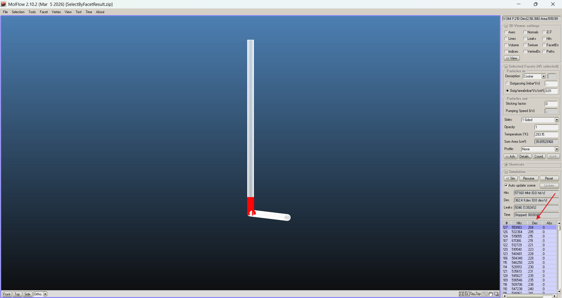

I’ve found a minor bug in the code. Specifically, the ‘selection by facet results’ function doesn’t work when I apply the filter to the ‘< DES <’ row alone. I’ve attached an example to show you that I’m unable to select the cells with a low DES value (i.e. less than 300).

I leave to Marton or Petar to reply and/or fix the bug… but you can still select the facets with less than 300 Desorptions: you hit the column label “Des”, see arrow in attached screenshot, until you in increasing order, and then using SHIFT-arrow:down you select all facets with DES<300.
